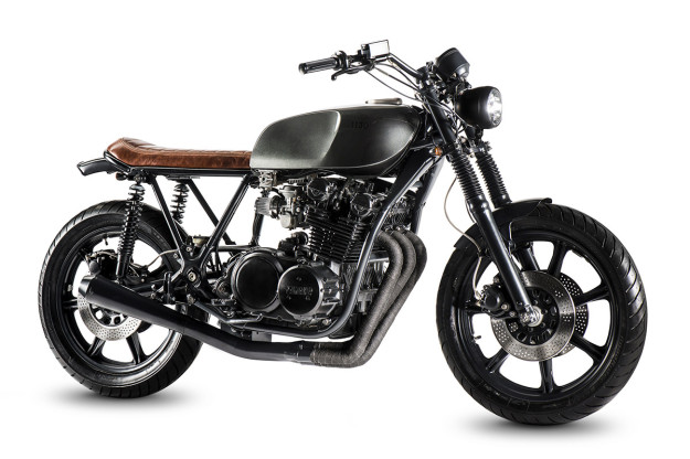

“I’ve been making things with metal and wood for my whole life,” Jules says, “and since I was a teenager I’ve wanted to build my own motorcycle.” So Jules bought a 1977 XS750, and found himself a tiny spot in an old factory. He worked at night, “accompanied by the local rats and mice.”

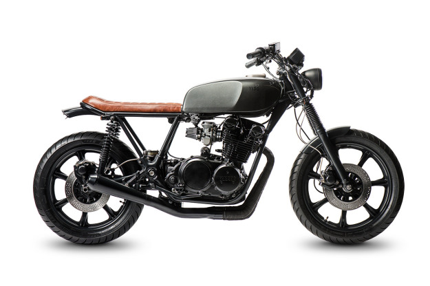

His XS750 is lean and lithe, very much in the current ‘Brat Caf?’ style, with immaculate detailing. The look might be skeletal, but the workmanship is solid.

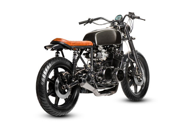

Jules overhauled and repainted the engine, and fitted compact cone filters and a custom exhaust system to improve the breathing. He’s cleaned up the frame and welded on a new rear loop before giving the whole lot a deep coat of black powder.

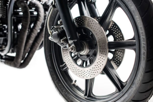

The overhauled forks are hiding stiffer springs and have been spruced up with gaiters and custom covers for the lower legs. The brake discs are drilled out and the calipers are hooked up to stainless lines.
The fenders are stock, but bobbed and powdered, and the standard wheels are now shod with grippy Avon Roadrider tires. The deceptively spindly rear shocks are Hagon and will improve the handling no end.

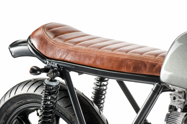

A slim leather seat has instantaneously transformed the usual heavyset looks of the XS750, and Jules has fitted a super-compact Ballistic battery to open up the ‘triangle’ under the seat.

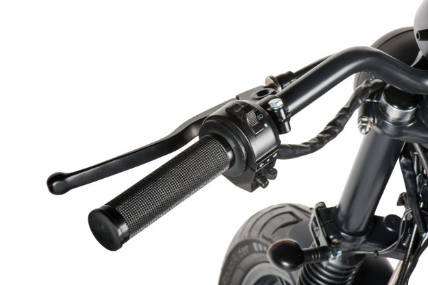

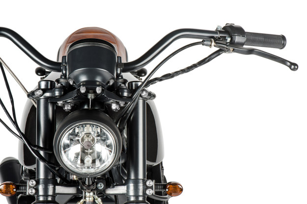

Adding to the minimal look are motocross-style bars, mini blinkers, a custom speedo bracket and new grips and levers. The compact headlight is powdercoated to match the rest of the bike.
The tank is one of the few items Jules left unchanged: a lick of dark paint was all it needed to match the rest of the bike.
