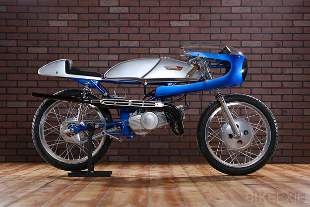

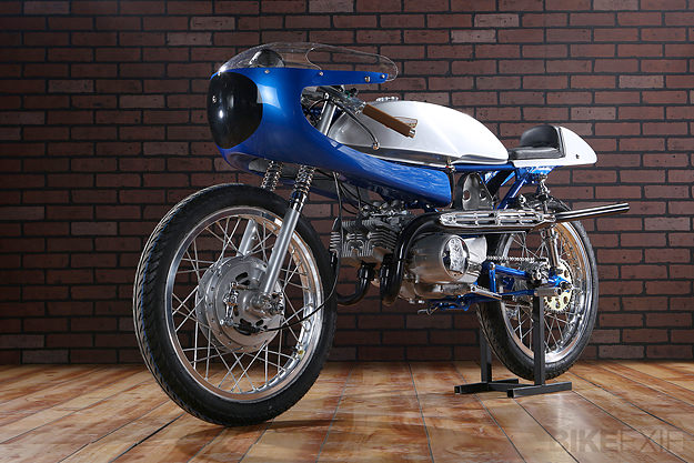

This beautiful 1969-model Suzuki T125 Stinger was built as a showcase for the products that Air-Tech produces from its facility in Vista, California. It’s a shining example of the meticulous approach that Kent prides himself on. “I like to do my customs so they look as if they came from the factory, that’s where the true artistry shows. I get a big smile on my face when people say, ‘Wow, when did they build that?’”

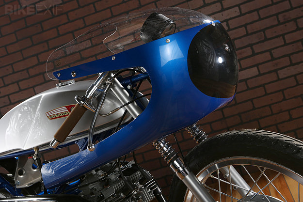

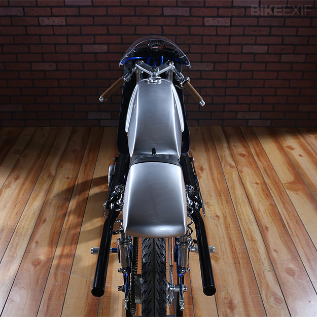

Starting with the bodywork, Kent stretched the original tank six inches before making a mold and reproducing a lightweight fiberglass version. Another mold was made for the tail unit, mimicking the rear curve of the tank. To balance the Suzuki’s lines, Kent installed a fairing that he’d originally designed for a Honda project, fabricating new fairing mounts himself.

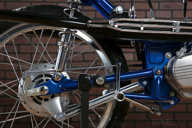

He also custom-made a set of clip-ons and rearset foot controls. A shouldered Akront rim was laced to the Stinger’s front end, and a T500 dual leading shoe brake machined to fit. Kent also machined the rear brake backing plate.

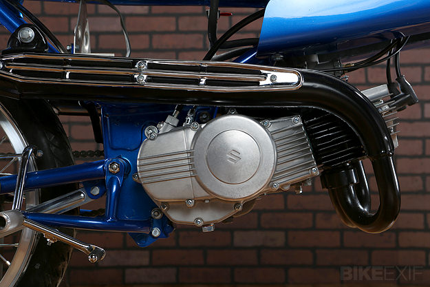

The Stinger’s two-stroke parallel-twin motor was stripped, media blasted, inspected and re-assembled with oversized pistons and new gaskets and seals. The 27mm front forks were rebuilt and a pair of YSS shocks added at the rear. Kent also replaced the swingarm’s rubber bushings with bronze ones.
A striking candy blue adorns the fairing and frame, offset by the silver tank and tail. Rather than simply machine polishing or powdercoating parts, Kent combined bead blasting, soda blasting and ball burnishing—“It makes the parts look like they would have come from the factory.” He even went as far as to have waterslide decals made for the tank, inspired by ’60s race bike badges.
